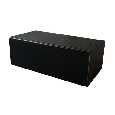

Chane 752

The focused, symmetrical loudspeaker
Midbass-treble-midbass (MTM) speakers center a high frequency device between two identical bass or midbass drivers. Get the blend between them exactly right and the MTM speaker has a wonderfully transparent,
uniform, room-filling sound.  It's just a better way to go.
Add the acoustic size of big premium 8" woofers and a professional imported horn treble system to this winning system, and the high definition Chane 752 out-images and out-plays lesser speakers that cost as much or even much more.
Size, focus, acoustical speed, and dynamic ease - the physics are clear.  Run the 752 full-range or add your powered bass system to round out a big multi-channel experience.
